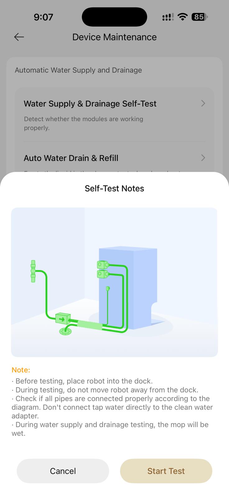

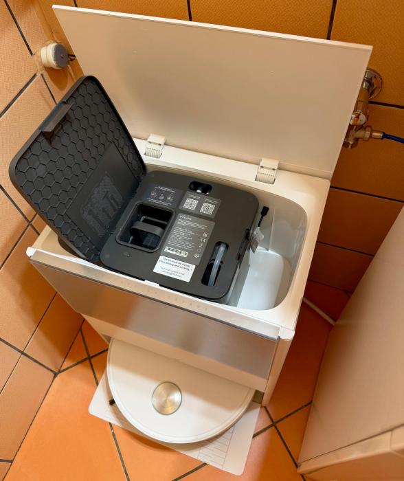

Question for Dreame and the Community: The Dreame Aqua 10 Roller Ultra is designed to be connected to the water and drainage system using the RAW 8 Water Hook-Up Kit. This product is not available in Europe, and although I contacted Dreame at the beginning of the year, they promised to let me know as soon as it was available. This has not happened. From the YouTube videos, it seemed like a very useful accessory, capable of eliminating the inconvenience of emptying and washing the dirty water tank and refilling the clean water tank. With the RAW 8 kit, maintenance is almost zero, as long as the robot doesn't freeze during navigation (as unfortunately happens now with both of my Aqua 10s). I ordered a kit on AliExpress in July. Although shipping took a long time, the accessory is perfectly compatible with the vacuum cleaner's base and is easy to install. It's so useful that I've already ordered a second one, hoping it will arrive next month. If the base is in a bathroom or a room with a drain, I highly recommend this purchase. The price is around 285 EUR.

Prego! La compatibilità è confermata da me. Infatti, dopo l'installazione, nell'applicazione compare un nuovo menu con opzioni specifiche per questo accessorio.
